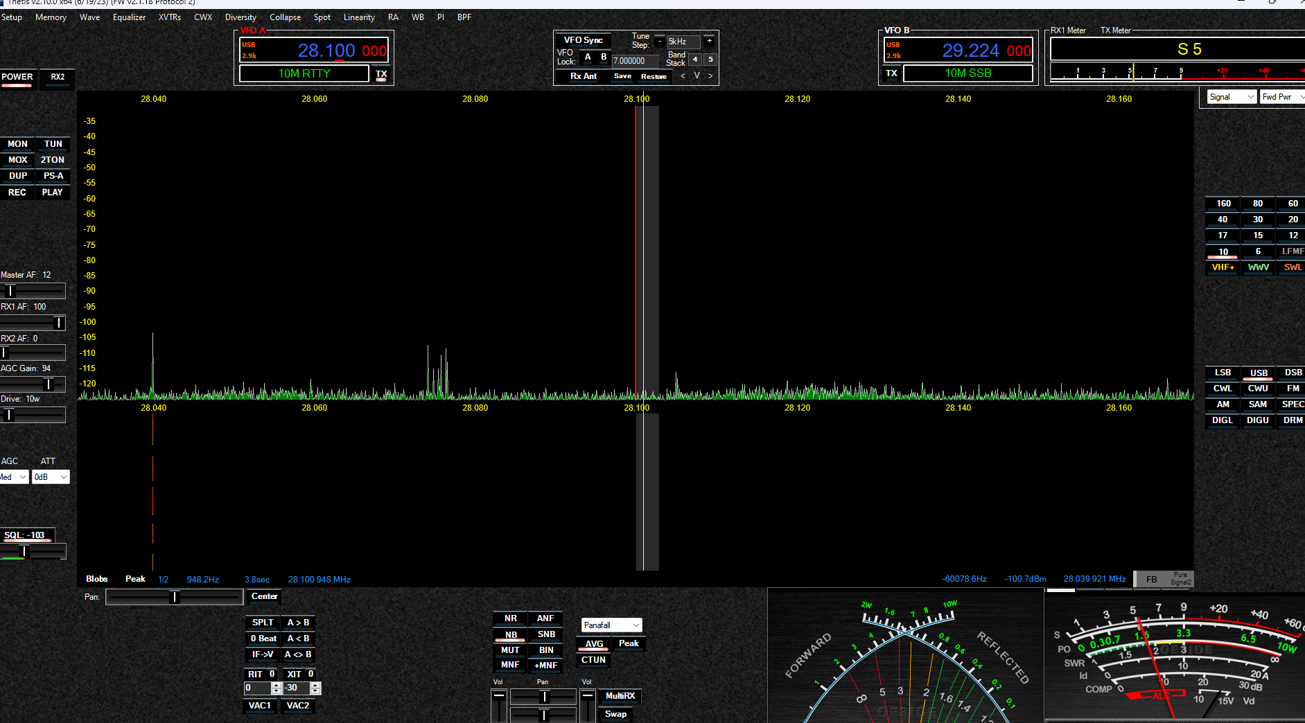

w-u-2-o wrote:Could you please describe an example of a configuration that doesn't work for you?
Right Here is on 10m and it wont let me activate it at that span. thats at a 768000 sample rate

i can increase the sample rate to 1536000 and can so may just do it that way. ty
Re: MultiRX range
ki4tga wrote:Right Here is on 10m and it wont let me activate it at that span. thats at a 768000 sample rate
Of course it won't. 29224 KHz - 28100 KHz is 1124 KHz. That is well outside your chosen sample rate, i.e. IF bandwidth, of 768 KHz.
You will be able to do this if you change your sample rate (IF bandwidth) to 1536 KHz.

yes on my next post i did so. ty for the quick response. i was unaware that sample rate=bandwidth. ty
